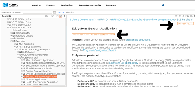

Is it possible to run Eddystone example from SDK12.3.0 on nRF51822 xx aa chip?
In the eddystone documentation it mentioned that S132 softdevice required, but on older SDK version experimental Eddystone implementation works with S130 softdevice.

Could you point me to where you read that the softdevice S132 is required? I can't seem to find it.
Have you tried the Eddystone example from SDK v12.3.0 with S130, without getting it to work?
I just tested this on a nRF51-DK, and for me it works as expected.

I attached the image from online documentation of SDK v12.3.0.
Also I tried Eddystone example from SDK v12.3.0 with S130 but it doesn't work, my chip is nRF51822 QFAA variant, may be FLASH and RAM regions are incompatible, would you please give me the FLASH and ROM setting? my current linker script is:

It seems that S130 isn't added to the documentation by mistake. So you should be able to use S130 as well.
I will double check and get back to you if I'm wrong.
The nRF51822 QFAA got 256k FLASH and 16k RAM, and I can't see anything wrong with your FLASH/RAM settings.
