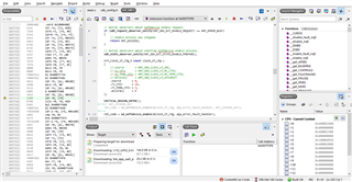

      I am working with the BL652 EVK from LAIRD. The EVK has nRF52832 IC inside of the module. I downloaded the "nRF5_SDK_15.0.0_a53641a" and trying to use "ble_app_uart_pca10040_s132” application. This application is for nRF52832 with external crystal. The EVK that I use does not have an external crystal. I modified the code like below. However, I can not successfully run the code in the MCU. What could be the problem ? Can anyone help ?

  • Alright, it doesn't look like a clock configuration problem then, I am using the same configuration on a BL652 right now and it's working fine (it's on a custom PCB though, not on the evaluation kit).
    I was going to suggest to make sure the SoftDevice is flashed along with the application but looking at your screenshot I think it's the case.
    I suggest that you check how the buttons and LEDs pins are mapped on your Evaluation board (SIO_13 to SIO_20 of the BL652) and make sure nothing will go wrong if the application tries to access them maybe.

            LED blinking is not the case since the flashed code is crashes somewhere. If there is another problem, then Why I can not debug the code, step by step?
           I think that I have the crystal configuration problem.

  • Are you not able to set a breakpoint in top of main? You should be able to debug the code even with the wrong LF clock settings. The LF clock is not started until softdevice init.
    Maybe you can post your hex file here. Then I can try to debug it and see if it hardfaults.
