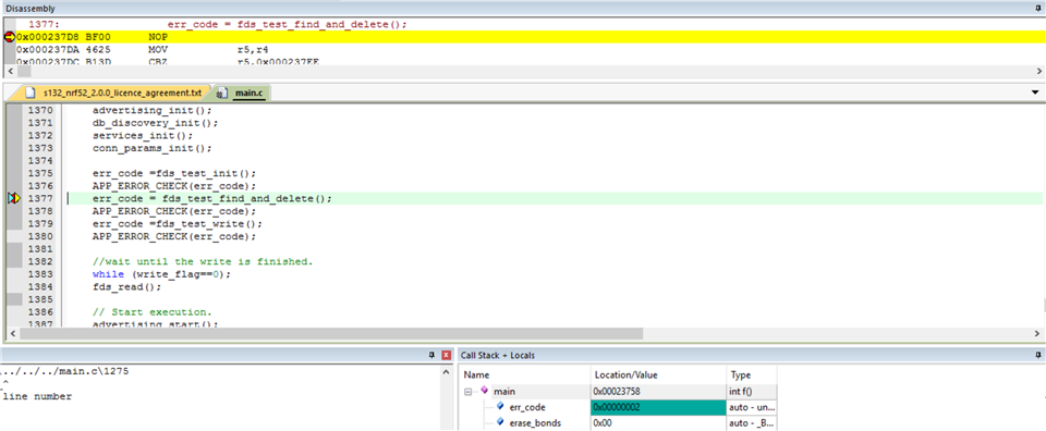

		/****************		TEST FDS		*****************/
		err_code =fds_test_init();
		while(fds_init_done==0);												//Waiting for initialization event for FDS

Can anyone help me identify why my flag "fds_init_done" is never set to 1.
while I am setting it the FDS event handler as follows:
 switch (p_fds_evt->id)
        case FDS_EVT_INIT:
            if (p_fds_evt->result != FDS_SUCCESS)
                // Initialization failed.
						else if (p_fds_evt->result == FDS_SUCCESS)
                // Initialization succeeded
								fds_init_done=1;
