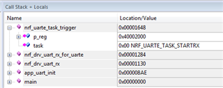

    I have done some more debugging and I have a question for you: Are you sure this is related to the GPIO and/or the RTT? What happens if you don't do anything after initializing the UART?

    As you can see it wasn't necessary to toggle any GPIO to make the RTS go low. It was only necessary to start the RX and this also happens inside APP_UART_FIFO_INIT().
    So it might be that this is just expected behaviour.

    I have debugged some more and I think the problem is that the RX task is enabled inside APP_UART_FIFO_INIT(), as I mentioned earlier. Here is the call stack with the path to the instruction.
    After RX is enabled, the UART feels ready to receive and hence activates the RTS signal. I don't think it is related to neither RTT nor any GPIO actions. At least I'm not able to reproduce that. The enabling of RX is embedded quite deep into the app_uart library and I couldn't find a way to cheat it. Hence I think you need to keep doing what you describe above, or drop the app_uart library and use the UART drivers directly.
