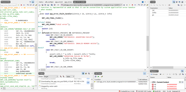

  • It's ok, my bad, I have found app_error_handler()
    So the app_error_handler lokks like this :
    /*lint -save -e14 */
    void app_error_handler(ret_code_t error_code, uint32_t line_num, const uint8_t * p_file_name)
        error_info_t error_info =
            .line_num    = line_num,
            .p_file_name = p_file_name,
            .err_code    = error_code,
        while(1);
        app_error_fault_handler(NRF_FAULT_ID_SDK_ERROR, 0, (uint32_t)(&error_info));
        UNUSED_VARIABLE(error_info);
    I just added the "while(1);" loop in order to follow the post you send me.
    So I debug the code and it stopped in the app_error_fault_handler() :
    __WEAK void app_error_fault_handler(uint32_t id, uint32_t pc, uint32_t info)
        NRF_LOG_FINAL_FLUSH();
    #ifndef DEBUG
        NRF_LOG_ERROR("Fatal error");
    #else
        switch (id)
    #if defined(SOFTDEVICE_PRESENT) && SOFTDEVICE_PRESENT
            case NRF_FAULT_ID_SD_ASSERT:
                NRF_LOG_ERROR("SOFTDEVICE: ASSERTION FAILED");
            case NRF_FAULT_ID_APP_MEMACC:
                NRF_LOG_ERROR("SOFTDEVICE: INVALID MEMORY ACCESS");
            case NRF_FAULT_ID_SDK_ASSERT:
                assert_info_t * p_info = (assert_info_t *)info;
                NRF_LOG_ERROR("ASSERTION FAILED at %s:%u",
                              p_info->p_file_name,
                              p_info->line_num);
            case NRF_FAULT_ID_SDK_ERROR:
                error_info_t * p_info = (error_info_t *)info;
                NRF_LOG_ERROR("ERROR %u [%s] at %s:%u",
                              p_info->err_code,
                              nrf_strerror_get(p_info->err_code),
                              p_info->line_num);
            default:
                NRF_LOG_ERROR("UNKNOWN FAULT at 0x%08X", pc);
        NRF_BREAKPOINT_COND;
        // On assert, the system can only recover with a reset.
    #ifndef DEBUG
        NRF_LOG_WARNING("System reset");
        NVIC_SystemReset();
    #else
        app_error_save_and_stop(id, pc, info);
    #endif // DEBUG
    /*lint -restore */
    at this line :
    my screen looks like this :
    Thanks for your help,
    Olivier
