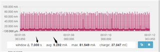

    I am now using nrf52832 development bracelet, I have nRF52 DK and nRF6707,Using the latest version of PPK software testing,I am now ready to use PPK to test the power consumption of the product.,The connection method is shown in Figure 1, Figure 2 is an enlargement of the upper left corner of Figure 1,Figure 3 is a software diagram of PPK,I have several questions:

   3.see Figure 3 and Figure4,When using PPK to test the power consumption of the product, the peak current is relatively high. What is the need to set in the actual test process? Press "CTRL + ALT + SHIFT + A" will appear "Switch levels" settings, how to set?

   8.see Figure 5:I used ppk to test the power consumption of the heart rate sensor, the maximum peak current reached 80mA, PPK can only measure the current of 70mA, why measured 80mA?
