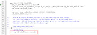

The BLE connection process is to establish a physical connection first and then discover the service to obtain the characteristic word information.

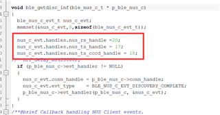

I want to reduce the time of connection so I want to get rid of the discovery service.
Because these features are consistent.

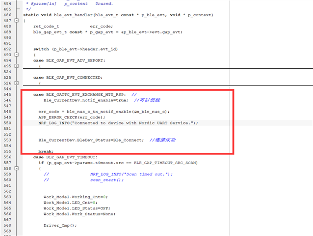

I have now made it possible for the host to send the data from the machine, but it can't receive the reply host from the machine to the host.

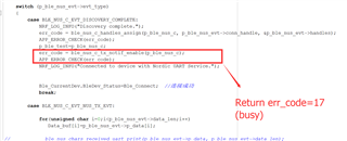

Because I always report busy when I can notif.
So now you can't have notif.
