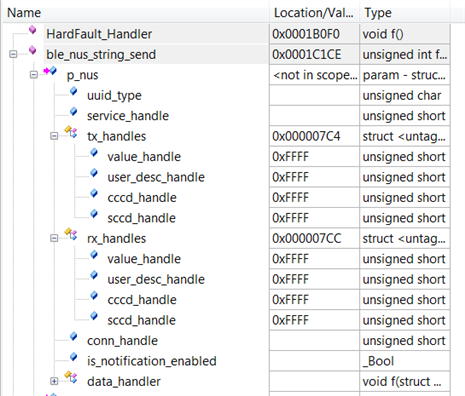

Now to my problem. I can't send data from any of the boards. When running only the peripheral board along with the nRF Toolbox app, it receives the data from the app but whenever I try to send data from the board to the app it gets disconnected. I use Putty and when just entering 20+ characters in the window, the app say:
[Callback] Central Manager did disconnect peripheral
Error Code: The connection has timed out unexpectedly.
Same goes for the central when trying to send to the peripheral. I get a HardFault when invoking the ble_nus_string_send function and more precisely the sd_ble_gatts_hvx function.
HardFault_Handler: 0x0001B0F0
What am I missing? Please help.
I'm using SDK 12.3.0 and softdevice s130.
