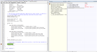

  • Hi Aryan,
    i am afraid i misunderstand you and/or need a little help. I started the project in debug mode (defined DEBUG and no optimazations) and set the breakpoint  app_error_handler() / app_error_save_and_stop in the app_error.c file.
    I get:
    • p_file_name = "main.c"
    • line_num = 501 --> that's the line where APP_ERROR_CHECK is called within the button_event_handler()
    • err_code = 13313 (0x3401):
      NRF_ERROR_STK_BASE (0x3000) + 0x400 -->
      NRF_GATTS_ERR_BASE (0x3400) + 1 -->
      BLE_GATTS_SYS_ATTR_MISSING (0x3401)
    So these are no new Information compared to NRF_LOG. Here is a screenshot:
    1. Could you please guide me where to place the breakpoints correctly?
    2. How do i check for BLE_GATTS_SYS_ATTR_MISSING equivalent to as we did for the invalid handle with if(m_conn_handle != BLE_CONN_HANDLE_INVALID)*?
    *even if i do not check for invalid handle, i get err_code = 13313.
    Thank your very much in advance
