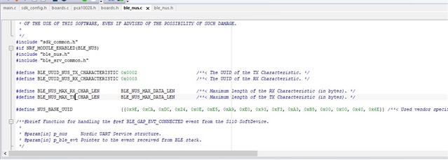

I am working on modifucation code of ble_app_uart example.
nRF51822
(SDK12.3.0_d7731ad)
Softdevice 130 (v2.0)
I know the original UUIDs are provided from the example is that
Nordic UART Service is 6E400001-B5A3-F393-E0A9-E50E24DCCA9E (16-bit offset: 0x0001).
TX Characteristic (UUID: 6E400002-B5A3-F393-E0A9-E50E24DCCA9E)
RX Characteristic (UUID: 6E400003-B5A3-F393-E0A9-E50E24DCCA9E)
My point is that I would like to change it to my own UUID without any changes.
MY SERVICE = "0000ff01-0000-1000-8000-00805f9b34fb"
MY READ = "0000ff06-0000-1000-8000-00805f9b34fb"
MY WRITE = "0000ff05-0000-1000-8000-00805f9b34fb"
I also have tried to change all of points that related to UUID values.
BUT When I change it, the UART function and advertising are stopped.
Please help my project kindly
