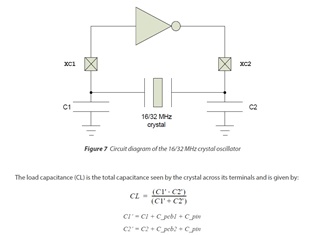

Let me confirm what's C0 in the nRF51 32MHz XO spec. It specifies as following but C0 definition cannot be found in the PS. I assume C0 is the load cap where C1 and C2 in the Fig7 below are the same. Am I correct?
RS,X32M Equivalent series resistance.
C0 ≤ 7 pF, CL,MAX ≤ 12 pF
C0 ≤ 5 pF, CL,MAX ≤ 12 pF
C0 ≤ 3 pF, CL,MAX ≤ 9 pF
