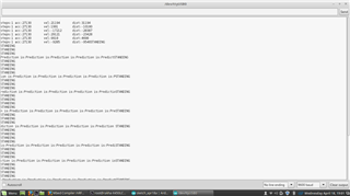

help me to combine this KNN using nRF51822_ADXL345 data using mbed compiler
Hello world
after several hours & day, Finally I have to implement this KNN code and nRF51822_adxl345 code. I have implement to one. but there is problem that..
I can't mix data properly like this one..
I wanna to implement this to foot gesture that clasify for standing, walking and climbing up the stairs.
but, that's not look a like. how to mix the good code for sort of step , acc, vel, dist and prediction in 1 row at serial monitor.. please help me to fix it..
this is my mbed code

       snprintf(buffer, 20, "data: %d,%d,%d,%d,%d,%d\n",(int16_t)reading_1,(int16_t)reading_2,(int16_t)reading_3,(int16_t)avg_1,(int16_t)avg_2,(int16_t)avg_3);

             uart1.printf("\nsteps:%i", (int16_t)steps);
             memset(&buffer, 0, sizeof(buffer));
             snprintf(buffer, 20, "\n%d\t", (int16_t)steps);
             ble.updateCharacteristicValue(uartServicePtr->getRXCharacteristicHandle(), (uint8_t*)buffer, sizeof(buffer), false);
            uart1.printf("\tacc:%i", (int16_t)totave[i]);
            snprintf(buffer, 20, "\t%d", (int16_t)totave[i]);
            uart1.printf("\tvel:%i", (int16_t)totvel[i]);
            snprintf(buffer, 20, "\t%d", (int16_t)totvel[i]);
            uart1.printf("\tdist:%i", (int16_t)totdist[i]);
            snprintf(buffer, 20, "\t%d\n", (int16_t)totdist[i]);

            printf("Prediction is:");
            switch (j)
            case 0:
                uart1.printf("STANDING\n");
            case 1:
                uart1.printf("CLIMBING\n");
            case 2:
                uart1.printf("WALKING\n");
    }while(true);
please help me soon..
