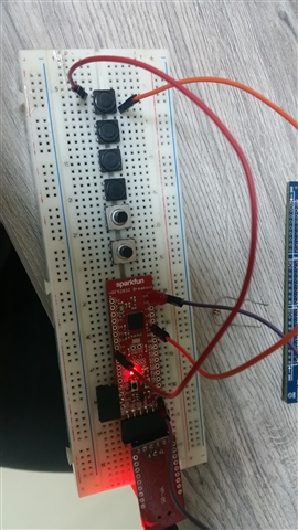

I Have a Problem About Pin_Read
Here is my code...
#include "Tus_Tarama_Deneme.h"
#include <stdbool.h>
#include <stdint.h>
#include "boards.h"
#include "nrf_delay.h"
#include "nrf_gpio.h"
#include "nrf.h"
#include "nrf_drv_gpiote.h"
#include "app_error.h"
#include "nrf_drv_timer.h"
#include "app_timer.h"
#include "app_button.h"
#include "nrf_drv_ppi.h"
#include "nrf_fstorage.h"
#include "nordic_common.h"
#include "ble.h"
#include "ble_err.h"
#include "ble_hci.h"
#include "ble_srv_common.h"
#include "ble_advdata.h"
#include "ble_conn_params.h"
#include "nrf_sdh.h"
#include "nrf_sdh_ble.h"
#include "ble_lbs.h"
#include "nrf_ble_gatt.h"
#include "nrf_log.h"
#include "nrf_log_ctrl.h"
unsigned char LED_YAN = 1;
unsigned char LED_SON = 0;
void gpio_init(void)
  nrf_gpio_range_cfg_input(16,10,NRF_GPIO_PIN_PULLUP);
void Tarama_Basla_Deneme(void)
  nrf_gpio_cfg_output(SUTUN_1);
  nrf_gpio_pin_set(LED_4);
  if(nrf_gpio_pin_read(SATIR_5))
    nrf_gpio_pin_write(LED_DENEME, LED_YAN);
  else
    nrf_gpio_pin_write(LED_DENEME, LED_SON);
  for(;;)
    nrf_gpio_pin_clear(SUTUN_1);
    nrf_delay_ms(50);
    nrf_gpio_pin_set(SUTUN_1);
    nrf_delay_ms(50);
and here is header file..
#define SUTUN_1       25
#define SUTUN_2       20
#define SUTUN_3       18
#define SATIR_1       16
#define SATIR_2       15
#define SATIR_3       14
#define SATIR_4       12
#define SATIR_5       10
#define LED_DENEME    15
 I want to when i pussed P0.25 P0.10 is read pulse and set I P0.15. Where is my mistake
    void in_pin_handler(nrf_drv_gpiote_pin_t pin, nrf_gpiote_polarity_t action)
        nrf_drv_gpiote_out_toggle(LED_DENEME);
      nrf_drv_gpiote_init();
      nrf_drv_gpiote_out_config_t out_config = GPIOTE_CONFIG_OUT_SIMPLE(false);
      nrf_drv_gpiote_out_init(LED_DENEME, &out_config);
      nrf_drv_gpiote_in_config_t in_config = GPIOTE_CONFIG_IN_SENSE_TOGGLE(true);
      in_config.pull = NRF_GPIO_PIN_PULLUP;
      nrf_drv_gpiote_in_init(SATIR_4, &in_config, in_pin_handler);
      nrf_drv_gpiote_in_event_enable(SATIR_4, true);
      for(;;)
        nrf_delay_ms(50);
        nrf_delay_ms(50);
    here is my solition.
