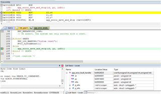

  • But sir code still stopped working at _configure().
    I tried to do debugging on keil.
    I did searched infocenter and different threads but could not get the idea about id,pc,info(i know definitions but how to use them to get to the error).
