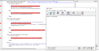

I try to run zigbee light example with IAR ARm.
When i start programm it return messages in terrminal window. but it are random symbols. I tried to use baudrates 9600 to 115200 but it has no effect, wht a problem with it?
Try 1000000 baud rate
Thanks a lot! i'm so blind!!!
