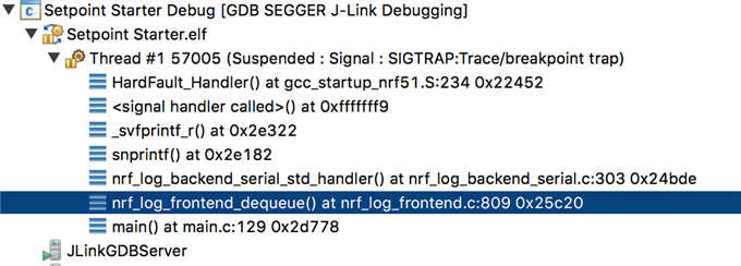

RTT overflow??
I've been instrumenting my Nordic app with RTT logging, which has been working great up until now. I use the deferred mode and use nrf_log_push() to queue all dynamic strings. These dynamic strings usually contain strings of hex numbers (e.g. "01 45 fe 23" etc.). Again everything has been working great until now.
But now I need to test with a much larger amount of data being delivered during a connection interval, and I get the crash shown in the screen shot. I've increased SEGGER_RTT_CONFIG_BUFFER_SIZE_UP to 1024 and NRF_LOG_DEFERRED_BUFSIZE to 1024 in sdk_config.h and it doesn't seem to help. These should be large enough to handle the RTT output occurring during one connection interval.
I don't have any idea how to debug the error shown in the attached image. Can you help?
