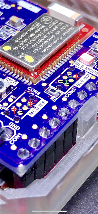

Hello all,
So I've ran into an unfortunate situation, our firmware team decided to ditch us just as we're about to launch our product. I got a dump from them including just about everything we ever paid them to do, and have made my way through programming our PCB boards via an AVR ISP MkII and getting our iOS and Android apps to compile via the ionic framework.
The last thing I've left to do to get us back up and running as we look for replacements is programming the Raytec MDBT40 which houses the nRF51822. Along the lines of developement we had decided to use Adafruits firmware for the unit as it had extensions written that were favorable to what we wanted to do with the module.
Looking through the dump, this seems to be the instruction set to upload the firmware via the 6pin connector on our daughter board, and from what I gather- we need to upload it via a JLink (which we have) but need the 20pin to 6pin adapter (just the PCB part, not the cable since we already have a cable that we use for the AVR ISP MkII).

Is there anything I'm missing? Does anyone know if I can buy just the PCB part without the cable? I know that seems silly but why have 2 cables?
Regardless, if there's anyway to do this update via OTA- a bit of help would be appreciated as I haven't found a way to do it via the Adafruit BLE app nor the Nordic BLE Connect app... every time I try to get the module into DFU- it disconnects.
Much appreciate any help and guidance, cheers.

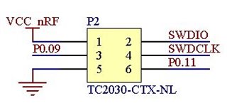

  • I'm not comparing it like that... I'm using the layout of the MCU jtag to verify that my probing was accurate, and that our pin 1 & 5 on the BLE jtag are flipped in polarity.
    //edit
    ...and to clarify (not sure if I mentioned this before) but I don't believe the BLE module was ever programmed via the jtag before- it either came pre-flashed or was placed onto a different hardware board, programmed, and then soldered to ours.
