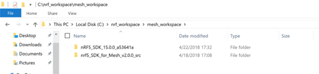

Hello Kino,
Have you download the nRF5 SDK 15, and place it at the same folder with nRF5 mesh SDK v2.0.0?
Please take a look at
https://infocenter.nordicsemi.com/index.jsp?topic=%2Fcom.nordic.infocenter.meshsdk.v2.0.0%2Fmd_doc_getting_started_how_to_build.html&cp=4_1_0_3_1#Manually

when I compile the project, it report error like this, F:\document\mesh\nRF5_SDK_15.0.0_a53641a\modules\nrfx\mdk\system_nrf52.c: No such file or directory, but my directory is F:\document\mesh\nrf_mesh_v2.0.0\external\nRF5_SDK_15.0.0_a53641a\modules\nrfx\mdk, how can I change compile directory?
Hello Kino,
Please place the nRF5 SDK 15 and mesh SDK at the "same folder", since the default setting path is configured for this.
