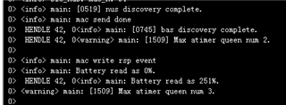

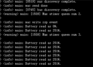

pair cause bas not have notify of central
i use sdk14.2  52832  as  central ,  have bas  service and  myself  service  it   have pair  process , there  are  one change question.  When I first burned the program, the bas service cccd was enabled and the power was read, but 0% of the read power and the power did not receive a notify after the power was changed, everything was normal after another connection or reset, I guess it is possible It was caused by the first pairing, but the specific question was not known. This was the only strange problem after the first burning process.
    I'm not sure if I understand your problem. Can you upload your project?

     * @brief Battery level Collector Handler.
    static void bas_c_evt_handler(ble_bas_c_t * p_bas_c, ble_bas_c_evt_t * p_bas_c_evt)
        ret_code_t err_code;
        static uint16_t batt = 0;
        switch (p_bas_c_evt->evt_type)
            case BLE_BAS_C_EVT_DISCOVERY_COMPLETE:
                NRF_LOG_INFO("[%04d] bas discovery complete.", __LINE__);
                err_code = ble_bas_c_handles_assign(p_bas_c,
                                                    p_bas_c_evt->conn_handle,
                                                    &p_bas_c_evt->params.bas_db);
                // Initiate bonding.
                if (m_pair_bound_flag) {
                    err_code = pm_conn_secure(p_bas_c_evt->conn_handle, false);
                    if (err_code != NRF_ERROR_INVALID_STATE) {
                APP_ERROR_CHECK(app_timer_start(rgb_flash_timer2, THREE_INTERVAL, NULL));
                /* APP_ERROR_CHECK(ble_bas_c_bl_notif_enable(&m_bas_c));*/
                APP_ERROR_CHECK(app_timer_start(bat_check_timer_id, APP_TIMER_TICKS(10000) , NULL));
                APP_ERROR_CHECK(ble_bas_c_bl_read(&m_bas_c));
            } break;
            case BLE_BAS_C_EVT_BATT_NOTIFICATION:
                m_battery_states_t = p_bas_c_evt->params.battery_level;
                NRF_LOG_INFO("Battery notify  %d%%.", m_battery_states_t);
            case BLE_BAS_C_EVT_BATT_READ_RESP:
                if (p_bas_c_evt->params.battery_level != batt) {
                    batt = p_bas_c_evt->params.battery_level;
                    m_temp_array.type = PHONE_CMD_BATTERY;
                    ble_nus_chars_received_uart_print(&batt, 1);
                NRF_LOG_INFO("Battery read as %d%%.", p_bas_c_evt->params.battery_level);
            default:
