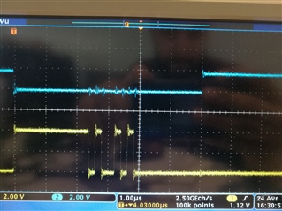

for my PCB, i'm using an NRF52832 as SPI slave, i send an array of 4 bytes {0xA5,0x00,0x01,ff},  but my SPI master receives always a byte (0xff) before 0xA5.
this ff byte corresponds to DEF byte, but i don't understand why its sent always before my frame ?!
The SPI master clock freq = 4 MHz
and i use the same main of sdk v11 spis example.
