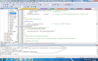

i have got error .i was trying to add but i failed

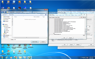

add that .h file into your project like go to target-->c/c++-->include paths. include the path from your project folder.

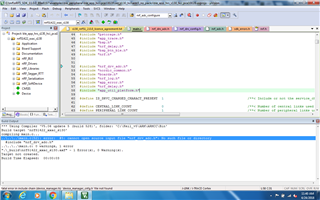

But i have tried ,see
how you are including your path. wait i will send entire sdk unzip it and open any example in keil. it will run without any error
ok
sorry, the whole file cant be uploaded.try to include path correctly
i got that
