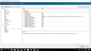

The softdevice should be included when you flash the application with SES. Can you check if the "Additional Load File" is pointing to the softdevice hex file?(Right click on your Project -> "Edit Options" -> "Loader" -> "Additional Load File")
In Additional Load File [0] "s132_nrf52_6.0.0_softdevice.hex" is already present as shown in below screenshot
Can you try with Python 32bit version?
