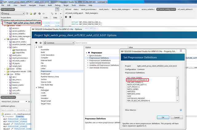

Encountered these while trying out Light Switch proxy example in Mesh SDK
I am using the proxy server and the proxy client example
  1. Initially Proxy Client and Proxy Server are present in MESH network. Once the Proxy Client recycle the power (power off and on), it’s not able to join back to the same network until the Provisioner is reset by clearing all the states.
  2. Initially Proxy Client and Proxy server are in MESH network.  When 3rd party BLE mobile application (using GATT barrier) is trying to connect to Proxy  Client/Server which leads the Client/Server to malfunction and got disconnected from the MESH network. Error info (<t: 5840504>, app_error_weak.c,   95, Mesh assert at 0x0002DB3E (:0))
