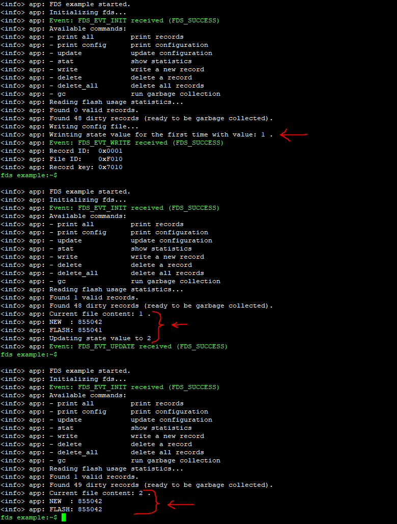

FDS Write: Wrong Written Data
Good Afternoon,
I'm writing some config data on an empty record the first time I turn on my board and updating that same record every next time I turn on the board.
While the writing of the first data is correctly written with fds_record_write() - when I check the data with fds_record_open() -, the data is totally wrongly written when I update the record with new config data, with fds_record_update().
When the board initialises I initialise FDS and call flash_write_record_setup(&DEVICE_struct_w_config2write) after initialising the softdevice.
By looking into the code below, do you have any cue why the data is not correctly written when I update the record?
Thank you,
João Oliveira

    I tested the flash part of your code by copying it over into the fds example in SDK15.0.0. I added some logging of the state struct member to see the initial write, value on boot and update writes. As you can see below where I started with an empty device and pressed reset twice, I first write the initial value of 1, then I update it to 2 and after that, the value is 2 already so no new update is performed.
    Here is the main.c file I used, the rest is just the FDS example in SDK15.0.0 unaltered:

        config2write.state = 1;
        config2write.adv2.enable = 12;
        config2write.adv2.time_adv = 13;
        flash_write_record_setup(&config2write);
        cli_start();
        /* Enter main loop. */
        for (;;)
            if (!NRF_LOG_PROCESS())
                power_manage();
            cli_process();
            delete_all_process();
    Basically, it seems like the code you sent me is working.

    I tried the code directly in the flash_fds example as per your code and it works fine.
    Yet, when I use exactly the same code in my app I'm struggling with code alignment erros with the fds_record_update() returning error FDS_ERR_UNALIGNED_ADDR. I guess the same could happen in your code eventually. How can I guarantee that the config2write address I'm trying to save on flash is word aligned?
    Thank you,
    João

  • Hi again Rune,
    After struggling a lot I just found out that the problem occurs when I try to write any userid string that has a number of bytes multiple of 4 (that is 4bytes, 8bytes, 12bytes, etc). It writes without any error but when I try to read that flash data afterwards the app gets stuck without reporting erros.
    I found it very weird and tested it then in the flash_fds example directly and the same issue occurs.
    Just try to write any multiple of 4 bytes string with the command "write fid key "multiple_of_4_bytes_string"" and then read the data by calling the "print all" command but with a NRF_LOG_INFO("%s", (char*)frec.p_data) line (or any other line that makes use of frec.p_data) inside the print_all_cmd function.
    I guess this is a very weird bug in the FDS API that might be related to word-unalignment in flash.
    Looking forward to hear about your clarification about this issue,
    João
