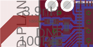

    My antenna design could use some cleaning up on the next board spin.  I have a ground plane on all of layer3 (layer2 is VCC), and I also ran ground planes around the top and bottom layers, thinking that it would be best to have the largest possible ground mass.
    I will continue to develop my firmware and test with the Desktop app, and I will be re-spinning my boards soon.  If you have any suggestions based on the attached picture from my current board's schematic (the antenna is from Nordic's Eagle Library) I would greatly appreciate it.  I know that I need some restriction around the output inductor, and I should probably just remove the ground plane on the top layer
