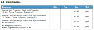

    1. The timeout seems to be 720 ms, which should be ok as it gives more than 20 missed packets before the link drops due to supervision timeout. (at a connection interval of 30ms)
    2. The accuracy used in the code is 20ppm but this needs to match the actual accuracy of the 32 KHz crystal as used by the manufacturer. The SDK code is intended to set the 32 KHz accuracy as it is on the board. If the number used in this case i.e. 20ppm is incorrect you will get link losses.
    Actions on your end:
    - Get the 32 KHz crystal accuracy from your manufacturer or from the datasheets of the module
    - Change the crystal drift to a higher level perhaps 50ppm or more and verify if the stability increases
    - You can also change the 32KHz source to the internal 32KHz RC source so you are not dependent on the module vendor's 32 KHz clock source. Verify if the stability increases.
