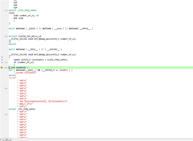

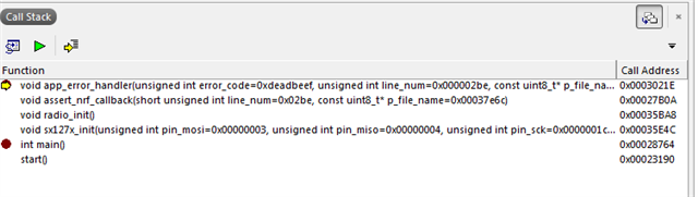

EDIT2: I have 2 exactly similiar devices(2 Nordic devkit pca10040 and 2 sx127 Lora radio) and the problem is that my code only works with one of them. The problem is the same as I cant see one of them adverstising after I built the code. I tried to debug as much as I could and I got the following errors:
It is in this function:
Do you have any idea what can cause this?
