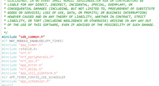

And if I try to manually add the app_button.c or app_button.h it shows empty:
I added manually the file app_button.c to the project, but it also didn't work. When I open the file it shows like this:

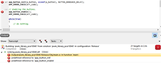

And I get the errors when building:

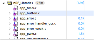

    I looked at the video tutorial. I added the files to the project:
    I edited the sdk_config.h:
    Still app_button.c shows like this:
    However, it gave me a different error when building:
    I added then the app_time.c as I did before for the app_button and edited again sdk_configh:
    Similar to app_button, the app_timer.c looks like this:
    Then, when I try to Build I get several error related with app_timer.c:
  • Hi Paulo,
     If you are having trouble adding certain things, I would recommend you to use the "Template_project" as a starting point. (found in the ["SDK\examples\peripheral\template_project"] folder.)
    It already has the libraries and drivers included, so the only thing you need to do is add:
    (if you are getting an compiling error with "micro_ecc_lib_nrf52.lib" check this thread)
