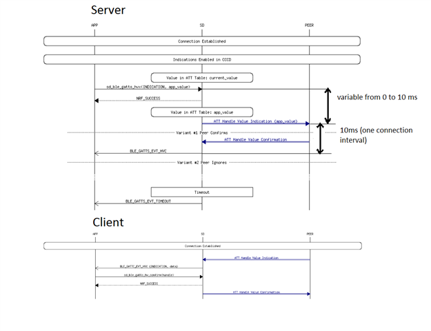

    The first image shows the timings I measured when I was sending an indication with sd_ble_gatts_hvx.
    The time between sending the packet and receiving it on my central (client) was variable between 0 to 10 ms, just like I expected it would be. And the time between receiving the packet on my central (client) and getting the acknowlegde on my slave (server) took one connection interval (10ms) every time.

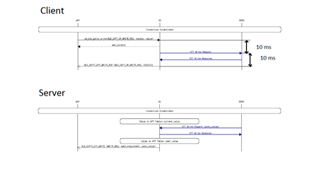

    This is what I would expect to happen. And I also thought it would happen if I did it the other way around using a write request. But when I measured the time it took from sending the message from my central (client) to receiving it on my slave (server) it was one connection interval (10ms) every time.

  • BLE_GATT_OP_WRITE_REQ is by design slow, since it rely BLE_GATTC_EVT_WRITE_RSP from the peer. I recommend to use the BLE_GATT_OP_WRITE_CMD instead if you need faster throughput.
