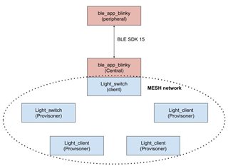

mesh2.0 coexistance with SDK15. Problem node configuartion
Materiel and software use :
SDK mesh 2.0.0
SDK 15.0.0
NRF52832 with PCA10040 x5
Situation :
I would like to implement this network :
I follow the instruction of the tutorial :  Coexistence with nRF5 SDK BLE functionality (Doc v2.0.0)
All the modification is in the nrf who implement the mesh and the BLE
Here is my main file :

The mesh initialisation is insert after the initialisation and the scan start of the BLE
My problem :
I Arrive to communicate whithout problem with the BLE communication but I have problem during the mesh configuration of the node.
When I start provisionning with the light_switch_provisionning the provisionning is succefull but the node configuration is unsuccefful.
I have this error message from the light_switch_provisionner :
<t: 2664438>, node_setup.c, 605, Acknowledged message status not received
<t: 2664440>, node_setup.c, 609, Retry ...
<t: 2664442>, node_setup.c, 361, Getting composition data
All the provisonner messages :
<t:      87712>, main.c,  361, Waiting for Client node to be provisioned ...
<t:      92473>, provisioner_helper.c,  282, Scanning For Unprovisioned Devices
<t:     127793>, provisioner_helper.c,  144, UUID seen: 0059ABCDEFABCDEFACCDEFABCDEFABCD
<t:     127797>, provisioner_helper.c,   95, UUID filter matched
<t:     128265>, provisioner_helper.c,  259, Provisioning link established
<t:     740151>, provisioner_helper.c,  254, Static authentication data provided
<t:    1678117>, provisioner_helper.c,  192, Provisioning completed received
<t:    1678120>, provisioner_helper.c,  197, Adding device address, and device keys
<t:    1678125>, provisioner_helper.c,  214, Addr: 0x0100 addr_handle: 0 netkey_handle: 0 devkey_handle: 2
<t:    1681368>, provisioner_helper.c,  155, Local provisioning link closed: prov_state: 2  remaining retries: 2
<t:    1681373>, main.c,  282, Provisioning successful
<t:    1681375>, provisioner_helper.c,  181, Provisioning complete. Node addr: 0x0100 elements: 5
<t:    1681379>, node_setup.c,  672, Configuring Node: 0x0100
<t:    1681382>, node_setup.c,  586, Config client setup: devkey_handle:2 addr_handle:0
<t:    1681385>, node_setup.c,  361, Getting composition data
<t:    1681449>, main.c,  117, Flash write complete
<t:    2664435>, main.c,  332, Config client event
<t:    3647492>, main.c,  332, Config client event
<t:    3647494>, node_setup.c,  605, Acknowledged message status not received
<t:    3647497>, node_setup.c,  609, Retry ...
<t:    3647499>, node_setup.c,  361, Getting composition data
<t:    4630549>, main.c,  332, Config client event
<t:    4630551>, node_setup.c,  605, Acknowledged message status not received
<t:    4630554>, main.c,  275, Configuration of device 0 failed. Press Button 1 to retry.
If I try with the exemple light_switch client the configuration is working. It's only when I try the coexistance.
Thanks in advance for reading my problem.
Axel Collet
