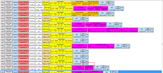

    I was confused with the problem of "re-pair".
    The condition is my device can only bond one phone (I was set the DEVICE_MANAGER_MAX_BONDS to 1).
    Then I successful bonded my device to my iphone which is called phone-A.  After that, I successful bonded my device to another phone which is called phone-B.
     At this time I think my device only bonded with phone-B.
    Then I reconnect to phone-A and I except a new pairing processing, but the phone-A directly connected with my phone, and the communication is not encrypted.
    The picture below is the processing when the "problem" happened.
     Is there any way to make phone-A to trigger automatic pairing  at this condition?
