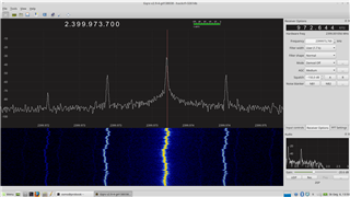

nRF24L01+ carrier wave
I can't find information what shape of spectrum I should expect from test mode (CONT_WAVE = 1, PLL_LOCK = 1). At the moment I get main spike with smaller symmetrical spikes -20dB and about +/1 kHz from main carrier.
I need somehow to remove these spikes and I am asking because if it is caused by design then nothing can be done to remove them (?), but I also have a suspicion that I am having counterfeit chip.
