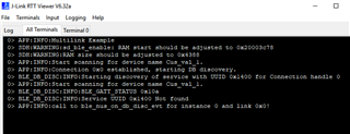

I have some trouble service UUID then i try to use the multilink central example project on a nRF51 dongle. I want it to have contact with a peripheral with sends a custom service. In the peripheral i have defined this: CUSTOM_SERVICE_UUID 0x1400 and CUSTOM_VALUE_CHAR_UUID 0x1401.
I changed the project from using ble_lbe to ble_nus. I have included the ble_nus_c.c file. In the ble_nus_c_h file i added #define BLE_CUSTOM_SERVICE_UUID 0x1400 and  #define BLE_CUSTOM_VALUE_CHAR_UUID 0x1401. At the same time I changed all BLE_UUID_NUS_SERVICE with BLE_CUSTOM_SERVICE_UUID in ble_nus_c.c.
When i try to run the project the central manage to connect to the peripheral but i can not find the service. I added a picture from j-link viewer bellow. I also checked what the BLE_GATT_STATUS is and it ses 0x10a which i found to be BLE_GATT_STATUS_ATTERR_ATTRIBUTE_NOT_FOUND.

    • What services and characteristics does the peripheral device have?
    • Is it ble_app_uart peripheral you are trying to connect to? If yes, did you make any changes to that peripheral example, e.g. the UUID values?
    • Your goal is to implement multilink central for NUS?
    • Does it work if you try the default UUID’s for NUS ?

  • Hey Sigurd,
    The service that the peripheral device have is 0x1400 and the characteristic is 0x1401.
    I followed this tutorial to make a custom service, https://github.com/bjornspockeli/custom_ble_service_example. So the peripheral device is made from the ble_app_template and modified as in the tutorial.
    Yes, that was the thought. Or is I maybe better to use something else when i want a custom service?
    I tried that fist before I remembered that the service and character on the peripheral side was different. I have not tried it with the ble_app_uart on the peripheral side.
    If you need multilink central support, then the multilink central example is a good starting point.
    Regarding the error "Service UUID 0x1400 Not found", please make sure that you also use the same UUID BASE on both central and peripheral. I.e. the CUSTOM_SERVICE_UUID_BASE that is used on the peripheral, is also the same as the UUID base used on the central side(originally named LBS_UUID_BASE on the multilink central example).
  • Yes, of course! My UUID was wrong..
    Thank you :)
