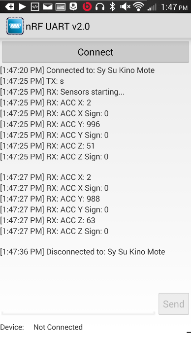

Hello, I'm currently using the nrf51822 and I'm trying to constantly send the accelerometer data to the nRF UART v2.0 Android Application. The application is able to print the data without any problems, however when I try to constantly print the data in a while loop, it will stop printing data statements a certain number of times.
Here is a sample of what is in my while loop:

And the code will iterate through the loop only twice, rather than constantly, and it will print 12 statements and disconnect as seen in the screenshot below:
image description
Some things I've tried are:
  • increasing the delay with the nrf_delay_ms function
  • using the ble_nus_send_string function to print instead of printf; causes the same result
  • repeating the same printf statement 12+ times within the while loop, however it always stops at 12 print statements and disconnects
  • flashing the onboard leds without the print statements results in the while loop to continue without any disconnections or problems
Are there any suggestions to try to get a constant flow of data to print out?
