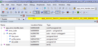

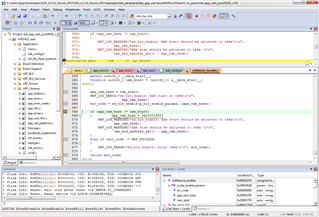

SDK12 DFU with NUS
Dear Nordic Team,
Thanks for supporting.
hardware : PCA10028 (DK 51)
Software : SDK12.3.0 ( NUS example )
Secure DFu implement with NUS example it is compiled and upload the DK51. But application is not run. I dont know what i am doing wrong. main file was attached here. Please support anyone.
My main File:

  • The SoftDevice will return the application RAM start address if too little RAM has been set aside for the SoftDevice when you call sd_ble_enable() in  softdevice_enable() in softdevice_handler. Specifically, it will return the app_ram_base variable, which contains the application RAM start address.
    You can examine the app_ram_base variable in a debug session, see attached screenshot below.
