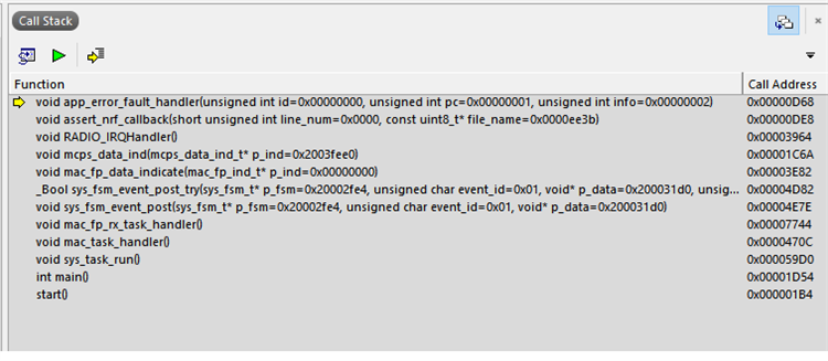

    It looks promising so far. Both radios are able to communicate but the nRf52840 throws an error under some conditions.  I can't debug the problem because I don't have the source files.
    Here is snapshot from the call stack:
    What do you mean with "don't have the source files"? Do you use the SoftDevice in addition to the 802.15.4?
    Can you try the following:
    Define "DEBUG" in your preprocessor defines,
    Disable Optimization (Set to -O0)
    Set a breakpoint in app_error_weak.c on line 90 (NRF_LOG_ERROR("End of error report") ), and then add p_info to your watchlist.
    Try to debug, and see if this breakpoint is hit. If it does, what is the function that returned the err_code that was passed into the APP_ERROR_CHECK(err_code); that the p_info is referring to? And what is the err_code?
    Edvin
    I was thinking that the problem was in a file that is part of the 802.15.4 library, that is what I meant with " I don't have the source files".  The problem was that we handle the 15.4 packet structure differently so I was able to fix it by modifying mcps_data_ind() function.
