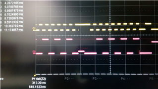

I wrote a pulse generation application on pin of nordic evaluation board to communicate from a sensor (according to the manual of that sensor)
however, there is s a step that the pin could not be high even it is set high in code by "nrf_gpio_cfg_output(30) and nrf_gpio_pin_set(30)" while the others are normal
and of course, i couldnt read from sensor as well as I want
So my question is there any possibility this caused by either Nodric (IO configuration) or by response of the senso. on that pin?
any idea or hypothesis, is welcome.
I attached the image extracted from scope, it is a little higher than zero level but still is lower than high level. The edge is circled is the issue
