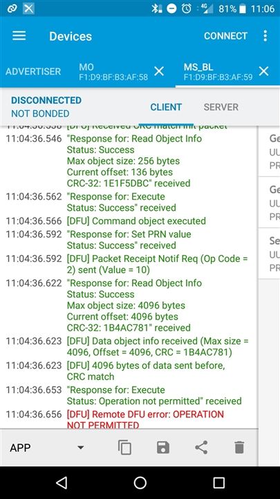

That issue looks critical as I simply can't resume the DFU if I try to send the same package. Here is a screenshot of nRF Connect:
Let me know if you have more question.

    I tried to replicate the bug using the examples you provide along with nRF Connect for Android (OnePlus 3T and OnePlus 6). I flashed my PCA10056 with the secure BLE bootloader and tried to upload the example image (hrs_application_s140.zip). I killed nRF Connect while uploading the image and after a few tests, I had the same bug.
    More information
    - It seems to appear when the bootloader doesn't reset at all after being disconnected: advertising resumes as expected, then I re-connect and try to send the same image, and got OPERATION_NOT_PERMITTED.
    Then even if it resets several times, I'm not able to send the same image and got OPERATION_NOT_PERMITTED each time I try to send the image.
    - But, if after being disconnected during upload, it resumes advertising but then reset (before reconnected and trying to send the image), the bug is not present anymore. Probably a variable not being reset correctly when disconnected.
    One workaround in the short-term would be to reset the bootloader when disconnected.

    Thanks to your report and detailed descriptions our software engineers have identified an issue: If the DFU is aborted at one particular moment, in-between two objects, it may enter the state that you are experiencing.
    It only happens on disconnect + reconnect, as that does not trigger a reset of the DFU target.
    The problem is that the connection is lost immediately after a create_object, and when the connection is reestablished the DFU controller performs an execute before resuming the update. They propose fixing it by resetting the settings on disconnect, either through (a potentially modified) nrf_dfu_settings_init(), or as you suggested by doing a reset.
