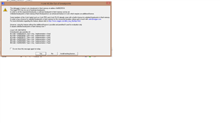

hi Support Team
Please Find Screen Short
I am using nRF52 DK
I am getting J-Link Debugging error , It is asking Licence Key

Hi, the license that comes with the Jlink lite used on the development kit does not include flash breakpoints so you should get a license if your require more than the 6 breakpoints supported in HW. However, as stated in the last paragraph, you are allowed to evaluate this feature.
