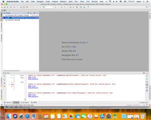

I downloaded nRF toolbox android source code from github.com/.../Android-nRF-Toolbox but it can't be built successfully, could you advise how do I do ?
You have to clone the Android-BLE-Library project (https://github.com/NordicSemiconductor/Android-BLE-Library/ ) to the same root directory, so that you have Android-BLE-Library and Android-nRF-Toolbox folders there.
Then, make sure whether the path to the :ble module in nRF Toolbox's settings.gradle file is correct. Sync project and it should work.
Take a look at this issue here: https://github.com/NordicSemiconductor/Android-nRF-Blinky/issues/4 (different project, but same issue).
