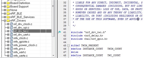

4) I have added nrf_drv_twi.c file in project's folder nRF_Drivers (I can open this file without issues):
Please advice what else should I do?
