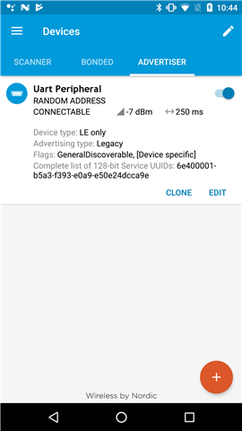

  • Can I use nRF Connect android app as the second board ? I want to use nRF Connect as the central. Is this possible and How ?
    In addition, In my final design, there will be multiple of BLE peripheral device. Therefore I need an acceptible solution. Do I need to connect that I need a MAC address ? I will select to connect a specific BLE peripheral from the central.
  • Hello Vidar,
       I can successfully connect to my phone by defining the UUID "6E400001-B5A3-F393-E0A9-E50E24DCCA9E" to my phone. However, I can not find Where it is defined in the central example. Could you please be more specific ?
