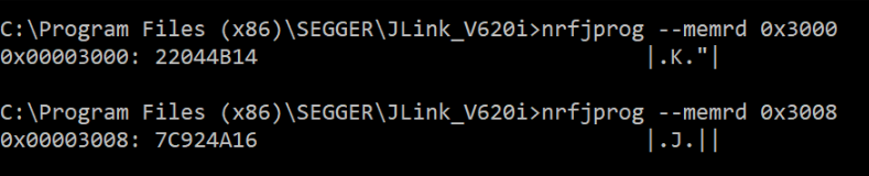

  •  This is what I get, soft device is s132 v2.0.0

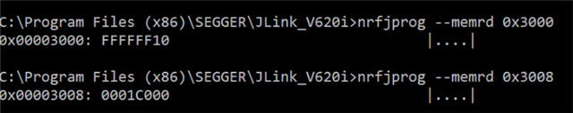

    2nd image is what i get after re-flashing the soft device, seems to be correct now. Whenever I flash my code however it seems to mess with the soft device. Is there maybe an issue with my linker file or makefile?
  • Okey, so maybe your code overwritten the softdevice.
    Where is there start address  of your application (and your bootloader if you have one ?) and where is your bin file located in the flash ?
