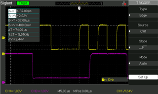

I've built a small sample on mbed of an I2c Scanner. Also tried other runtimes. Somehow, its not working.
I'm using a GY-45 Module, which wraps MMA8541 on it:
By looking, it seems that technically, its resistors are at 4k7, while in truth, I only measured 2k2 on the board, which is puzzling. I applied into a scope and got a few dumps:
Any ideas of what can I do?
