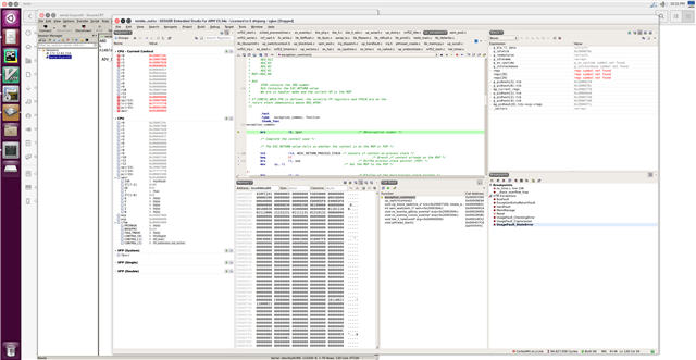

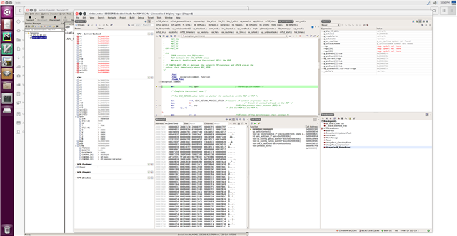

Dear all,
I'm trying to run nimble stack with Nuttx  OS on nrf52832(pca10040) reference board. Now , most function is working , but it is not stable .
Sometime , the svc call will cause usagefault exception , but my priority is all right configuration (svc is 0x00 , no other isr is higher than svc).
I'm not sure is there chip internal bug for the calling sequence ?  Thanks.
