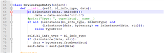

Hi all,
I am testing DFU example in Mesh SDK . I follow this tutorial : http://infocenter.nordicsemi.com/index.jsp . But when I execute to step 4 :
dfu$ python device_page_generator.py -d nrf52832_xxAA -sd "s132_5.0.0"
I get this error :
Any suggestion for this ? I use NRF52832 DK . Thank !!!

    The issue is that the public key isn’t being converted to a bytearray properly.
    Applying the following diff will solve the problem
    diff --git a/tools/dfu/device_page_generator.py b/tools/dfu/device_page_generator.py
    index 9fa9e6435..a3aa74028 100644
    --- a/tools/dfu/device_page_generator.py
    +++ b/tools/dfu/device_page_generator.py
    @@ -66,7 +66,7 @@ class DevicePageEntry(object):
             #print("Type: ", type(data).__name__)
             if not (isinstance(bl_info_type, BLInfoType) and
                     (isinstance(data, bytearray) or isinstance(data, str))):
    -            raise TypeError
    +            raise TypeError("Invalid type %r" % (type(data)))
             self.bl_info_type = bl_info_type
             if (isinstance(data, str)):
    @@ -96,7 +96,7 @@ class DevicePage(object):
             self.softdevice = softdevice
         def generate_entries(self, platform, softdevice, bootloader_config):
    -        public_key = bootloader_config["public_key"] \
    +        public_key = bytearray.fromhex(bootloader_config["public_key"]) \
                          if "public_key" in bootloader_config else None
             if public_key:
                 self.entries.append(

    Best,
    Thomas
  • Hi Giang,
    -            raise TypeError
             if public_key:
    Additionally, there was an issue where the device_page_generator.py would always output the same filename (device_page_nrf52832_xxAA_s132_6.0.0.hex). That is fixed with the following diff:
    index a3aa74028..0e8eb9e3d 100644
    @@ -207,7 +207,7 @@ def main():
         for plt in platforms:
             plt_str += ''.join(plt["name"]) + '\n'
    -    SOFTDEVICE = "s132_5.0.0"
    +    SOFTDEVICE = "s132_6.0.0"
         DEVICE = "nrf52832_xxAA"
         parser = argparse.ArgumentParser(description="Device Page Generator")
         parser.add_argument("-d", "--device", help="Select device: " + ''.join(plt_str),
    @@ -217,12 +217,15 @@ def main():
         parser.add_argument("-c", "--bootloader-config",
                             default="bootloader_config_default.json",
                             help="Bootloader configuration file")
    -    parser.add_argument("-o", "--output-file", help="Output hex file",
    -                        default="bin/device_page_%s_%s.hex" % (DEVICE, SOFTDEVICE))
    +    parser.add_argument("-o", "--output-file",
    +                        help="Output hex file (default: bin/device_page_%s_%s.hex)." % ("<DEVICE>", "<SOFTDEVICE>"),
    +                        default=False)
         parser.add_argument("--all", default=False, action="store_true",
                             help=("Writes all known device page combinations to "
                                   + "\'bin/\'"))
         args = parser.parse_args()
    +    if not args.output_file:
    +        args.output_file = "bin/device_page_%s_%s.hex" % (args.device, args.softdevice)
         dirname = os.path.dirname(args.output_file)
         if not os.path.exists(dirname):
    For your convenience I’ve uploaded a copy of the script with the changes applied:
