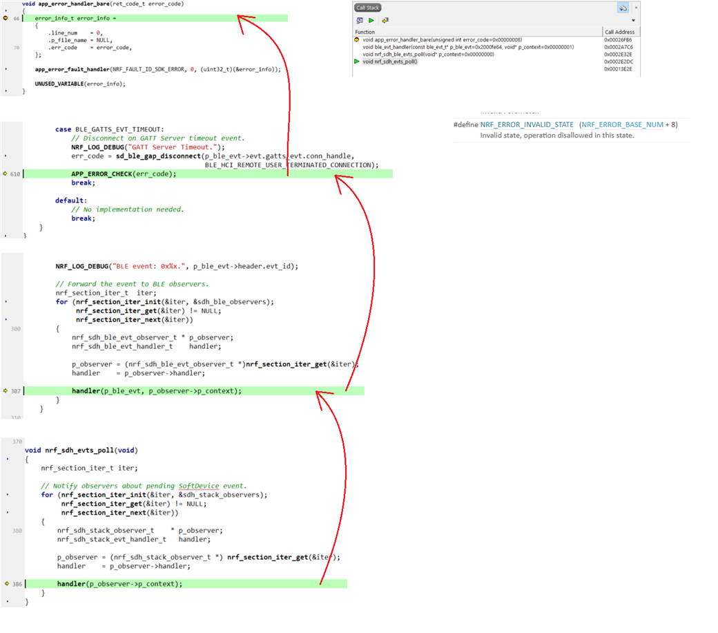

  • Update on this error:
    I have set breakpoint inside app_error_handler_bare function in app_error.c file and below there is call stack with error of invalid state.
  • Update number 2 on this error:
    I have added  NRF_LOG_INFO("event nr: %x", p_ble_evt->header.evt_id); and commented below case

    I don't like how I got no control over this. I mean the case inside the switch isn't supposed to be just commented out, right?
