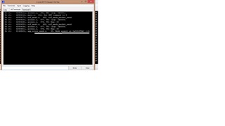

Testing Light Switch Example Mesh SDK 2.01
4 nRF52 DK
1 DK -Provisioner
1 DK -Client
1 DK - Server
1 DK Server Proxy
Please Check the Log
Also Check Mobile Screen Shot Mobile Screen Shot
Assert Error when Down Arrow Clicked on Mobile

Could you please upload the log & the mobile screen shot again please? I could not read the text on either picture because the resolution was so low. I believe it is something weird with devzone (not something you have done). It normally works fine if you press Insert -> Insert image from image/video/file.
Have you taken a look at what assert error you are getting? Looks like it is inside app_error_weak.c. You can take a look at the map file generated & search for the address 0x0002F8AC to see where the error occurs.
