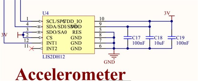

I'm using the nrf52832 chip and I'm trying to communicate with a LIS2DH12 accelerometer using the I2C protocol.
But unfortunately I can't handle with it, it seems that the accelerometer doesn't respond at his adress...
So first here is my hardware connections :
The pin are connected as follow to the nrf52832 :
SDA - P0.14
SCL - P0.15
As said in the LIS2DH12 datasheet, the SD0 pin is connected to the supply voltage so the I2C address of the accelerometer is 0x19.

The program get stuck in the first while loop :
while (m_xfer_done == false);
And using a breakpoint, I can see that the twi_handler() is called because an NRF_DRV_TWI_EVT_ADDRESS_NACK event is rised.
So it seems that the lis2dh12 does not respond...
I tried to "scan" every adresses from 1 to 126 and for each I receive the same event : NRF_DRV_TWI_EVT_ADDRESS_NACK
Is there a configuration that I forgot ? Maybe the SDA and SCL pins needs to an internal pull-up ?
I don't understand, so if someone could help me, it would be great !
