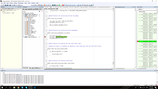

Hi
i'm trying to create my own custom service, but it doesn't work , i can't service at nRF Connect
i use ble_app_template from SDK v15.0.0
when i debug it, code from power_management_init(); , stop at NRF_BREAKPOINT_COND
Thank you

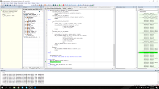

hi.... i am working on ble_uart in segger ... while i am debugging my program stop at nrf_breakpoint_cond ...same issue
how to enable the logging ... please have a look at pic...
NRF_FAULT_ID_SDK_ERROR:
NRF_FAULT_ID_SDK_ASSERT:
these are disable in my app_error_weak.c
